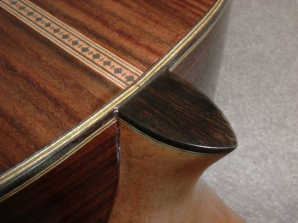

I dye my maple bindings and purfluings as well as make my rosettes out of dyed maple veneer. It's taken me a couple of years to get the process down. I use a fairly large pressure cooker at very high pressure for two hours. I wrap the maple in a coil against the inside wall of the pressure cooker and turn the maple once with the inside facing out. you need patience to let the pressure cooker cool down or it explodes dye all over (ask me how I know). Vacumn does not work, I've tried. All the bindings and inlays in this picture are dyed using the pressure cooker

daryl
do you soak bindings first to get them flexible enough to coil into the cooker?

It's a large sized canning pressure cooker and I laminate the bindings from veneer after they are dyed.   When the laminates are glued together with cynoacrylate (super glue), you don't see the joints and they are flexible enough that they don't require using a bending iron or my fox side bender. If I require more of a bend I soak them. It's very time consuming and rquires patience but the end result is worth it.
As for the vacumn pump. I have a fairly powerfull vacumn clamping system for laminating carbon fibre to wood etc. and it coudn't pull the dye into the wood even after 24 hours.
